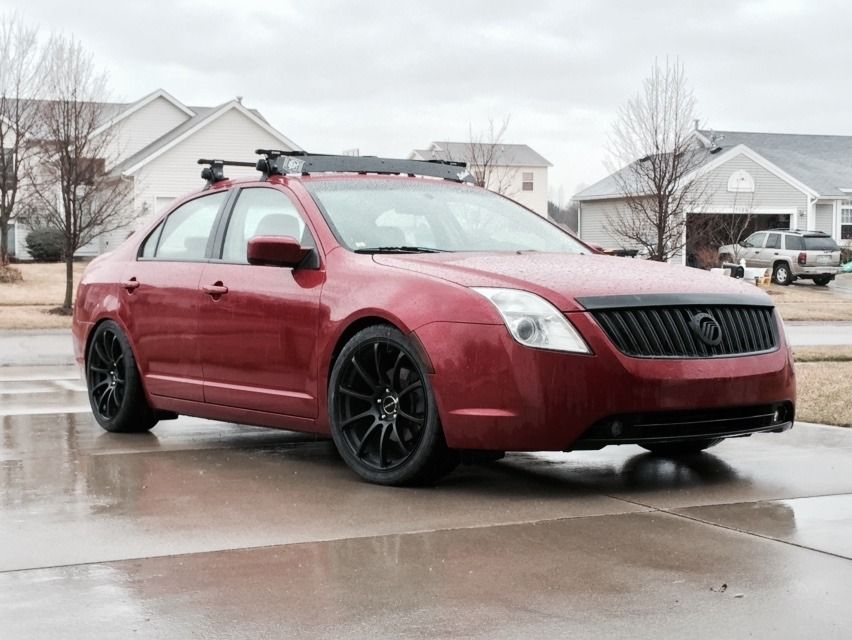

Alright guys,
I got them mounted this morning! I like them a lot and they balanced out well. Time will tell how the quality is... The Mickeys are very responsive and the road noise isn't bad...
Sorry for the wet weather and dirty car pics!
I have red lug nut to go on, but when I was laying them out, 12 out of the 20 were the wrong size :angry: So those will be sent back and hopefully here in a week or two, please excuse the ugly chrome! Haha... I will be painting the center caps matte back too.
I might get some 5mm spacers to get a little more poke.. What do you guys think?!
I'm also not liking the front having more wheel gap than the back... Hmm

Anything 8" wide or greater with an offset of more than 30 will most likely rub. Your on the line now unless you add more camber (requires specific ball joints @$100 ea).
they are cheap enough you can give it a shot tho.
what are you dropped on? looks like an eibach spring... could go lower with a tein S-tech or Vogland

Yeah I wanted to stay at 30-32... I might custom order 3mm for the front and try 5mm in the rear. I know I have the room in the back for 5s...
I have S-techs already... I thought the front would sit lower, to be honest, after seeing some other guys on here.

They might settle a little bit lower I'd imagine.
