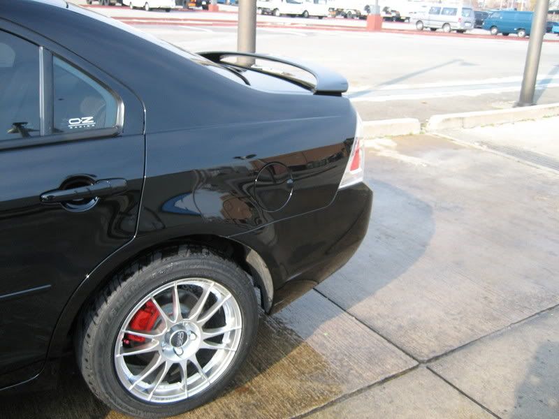

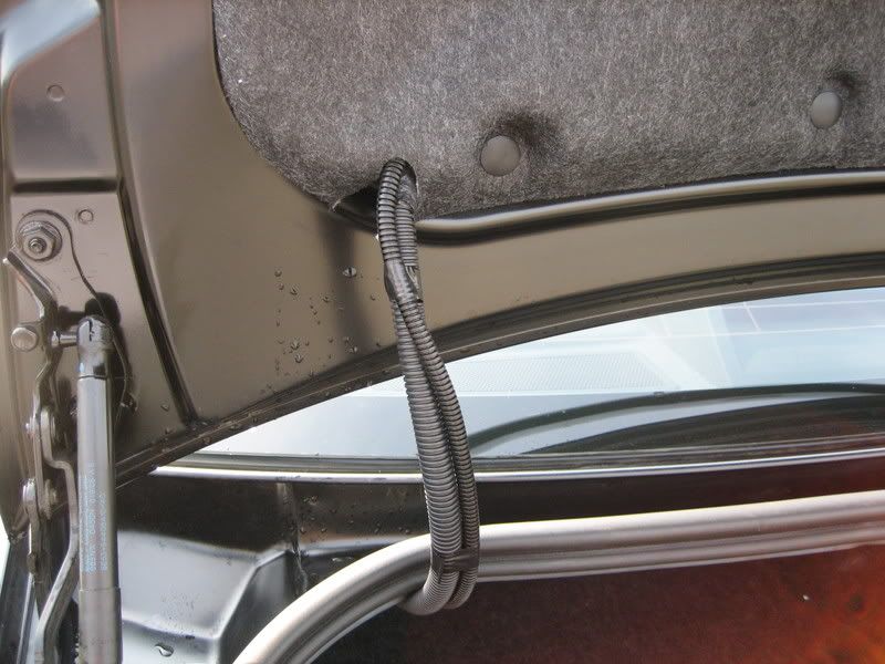

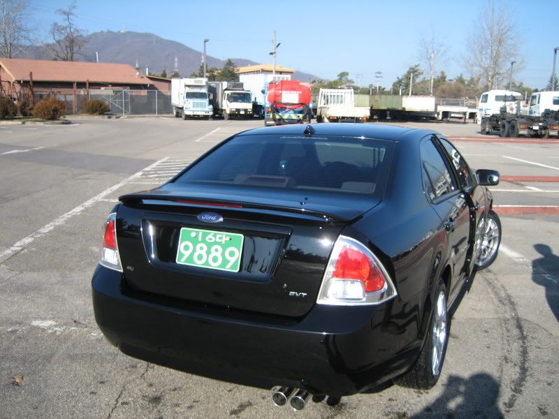

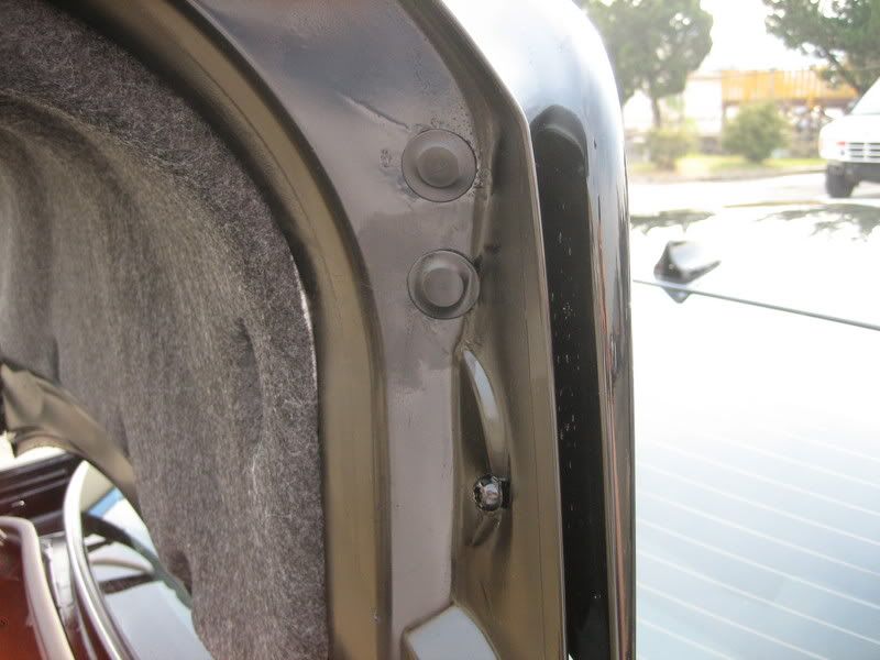

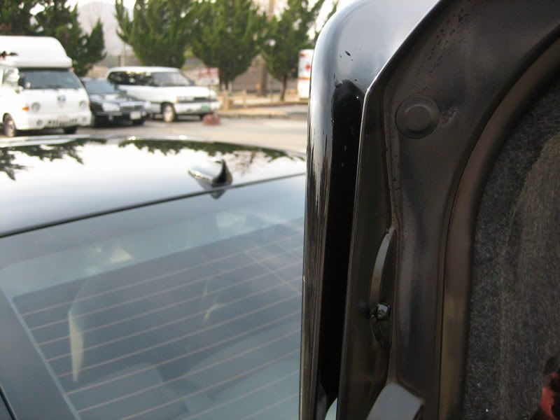

ordered from spoilers-direct, its for a fusion but drilling the holes on the outside to the inner side of the trunk is hard because of the angle of the sheet metal. you drill 5 holes on the trunk, 4 for the spoiler and 1 for the light bar. you don't need to drill through both sheet metals for the light bar because you can run the wire out of the big holes under the trunk similar to how the tag light wiring is done. after drilling the holes i sprayed undercoating to prevent rust, finished up by putting on the spoiler and putting rubber caps in the holes. looks factory.

you can see the top of the spoiler just a tab when backing up. so you can tell where the rear of the trunk is now.

I installed it last night and have pix of every step i took so i will try and get a write up going. For me it makes it easier to back up as i know were the back of the car is now. Before i could not see any of the trunk so looking out the rear view for backing up sucked because there was no refrence as to the back of the car. Now the spoiler is there and at the very back of the trunk so i know were i am at. You can see it in the rear view but does not block any view at all or at least it does not bother me at all. I love it. Gives the car a new look and again helps me see out the back because i know know were the back of the car is. Hope i explained that right :lol: Here is the same one i got from the same seller. Got it in 3 days and very good seller.
