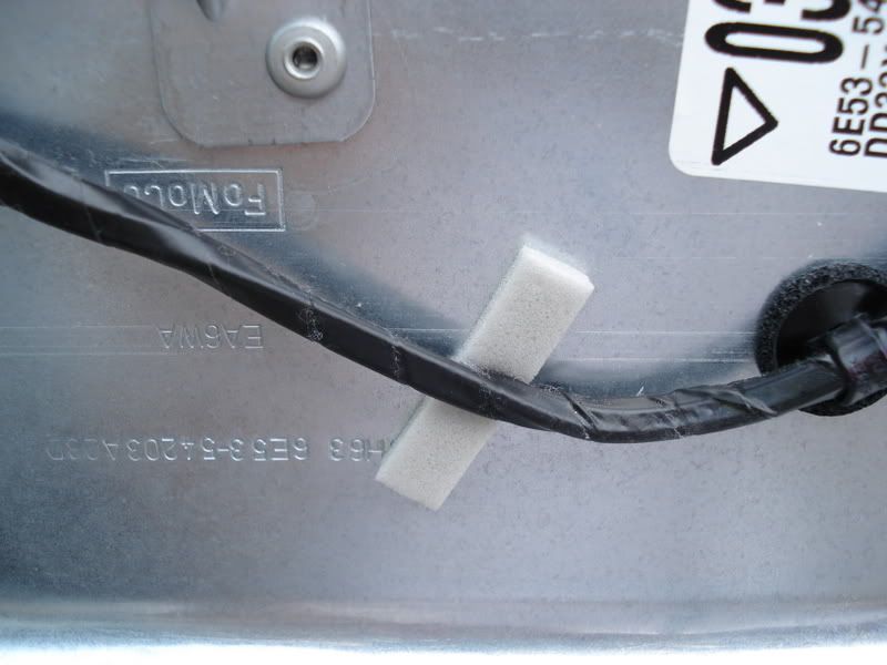

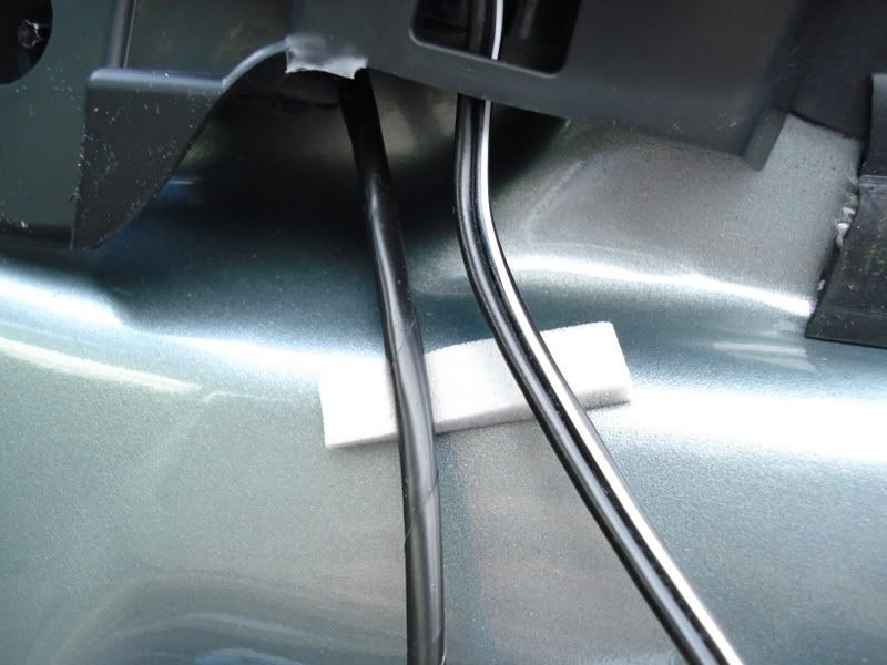

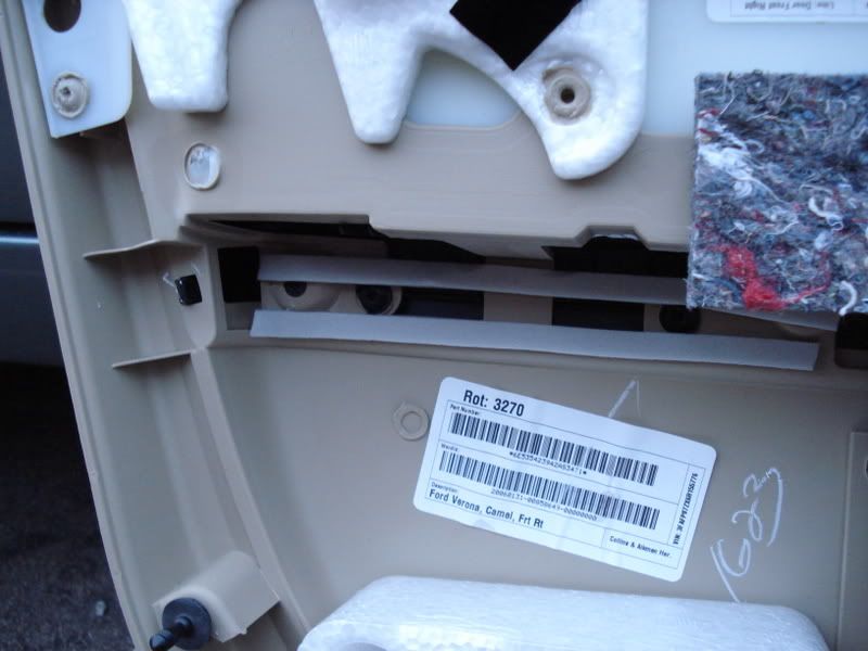

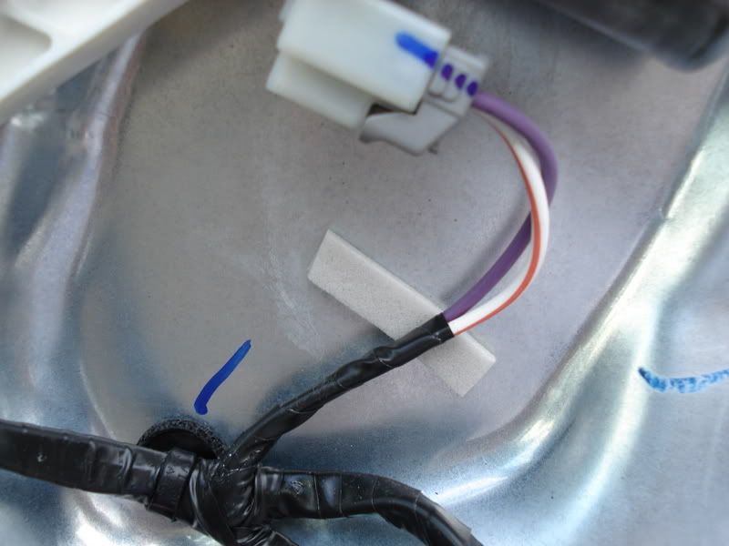

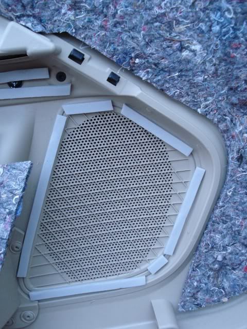

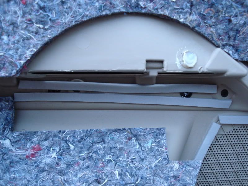

Not quite done yet but here are pics of my attempt to fix the passenger door rattles. From what I have read on here I'm not the only one suffering from these rattles in the door. I put foam tape in the problem areas that I thought were rattling or might rattle in the future. One of the main rattles that was stereo related was the door panel vibrating against the speaker. That is now fixed. My car has been rattle free up until 10,000 miles or 1 month ago. It now rattles like crazy all the time, stereo on or not, at all speeds, and on any road surface. It drives me nuts. I narrowed it down to the door latch, don't know why it is rattling, but it is and I cannot get at it. I will have to see if the local dealer authorized mechanic can fix it but I know what they are going to say, it will either be "not fixable" or "can't duplicate problem." After putting the door back together I now have another loud rattle when using the stereo, it is the lower right section of the door panel. I will have to pull it off again and put more foam tape there. Thats all for now, I will update in the future with more results.
Foam around speaker area, I highly reccomend this.
