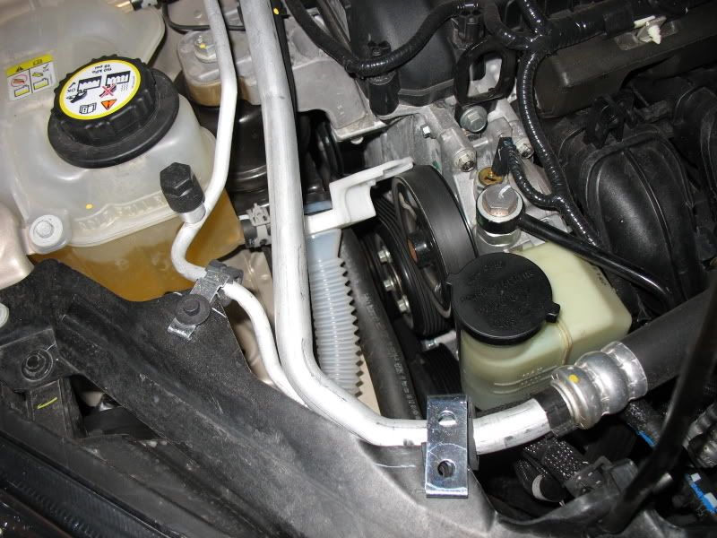

2. Unbolt the 8mm screw that holds the washer filler neck, and move the filler neck out of the way to gain access to the headlight.

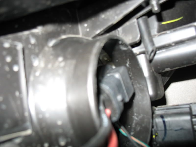

3. Remove the stock halogen bulb
a) Peel the rubber dust cap off the back of the headlight
b) Turn the bulb assembly counterclockwise and pull the bulb out
c) Disconnect the connector and set the bulb aside.
4. Carefully install the HID bulb (CAREFUL not to touch the glass with your fingers)

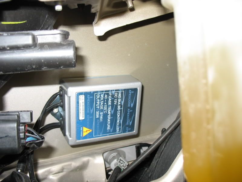

5. Mount the Ballast
a) I chose to use the double sided tape that came with the kit instead of mounting screws. The tape is more than strong enough because of the huge surface area of the ballast and mounting location. Mount the ballast to the flat sheet metal area next to the headlight.

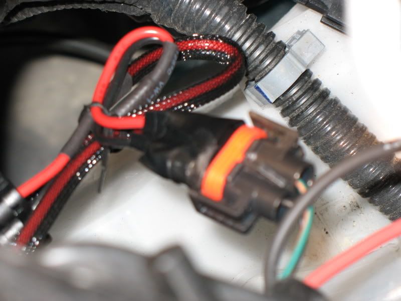

6. Connect the connectors supplied from the ballast to the bulb. This step is self explanatory as the connectors only fit a certain way. I'll include a pic nonetheless, heh

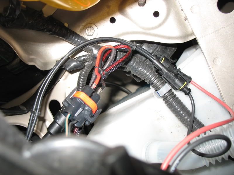

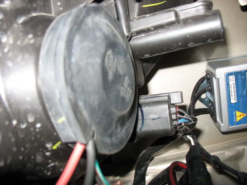

7. Connect the red and black wires from the ballast to the OEM headlight harness. Insert the pins into the harness until you feel a little click. The positive (red) wire connects to the green (with brown stripes). Then do the negative side (black to black).
Use some electrical tape to cover the connection
8. Cut a tiny slit into the dust cap so that the wires can still come out and place the dust cap back onto the lamp assembly.
That's it for the driver's side! Make sure to bolt the washer filler neck back down.

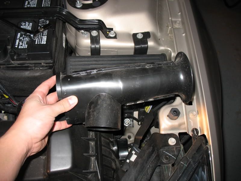

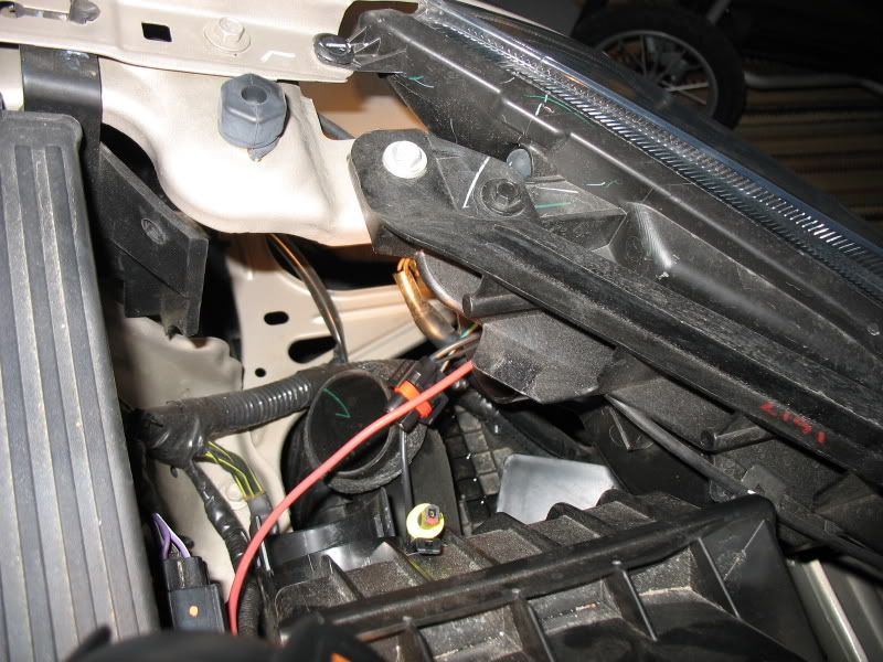

2. Remove the air silencer by simply pulling it off the airbox. I did this to improve the sound of acceleration as well (so you can just leave it off 8) ).

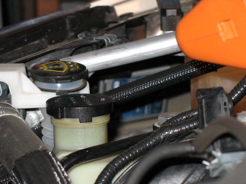

3. Unclip the rubber shield behind the headlight and move it out of the way
The result should look like this before you proceed.

8. Replace the rubber shield by clipping it back. Also, replace the air silencer (if you choose to).

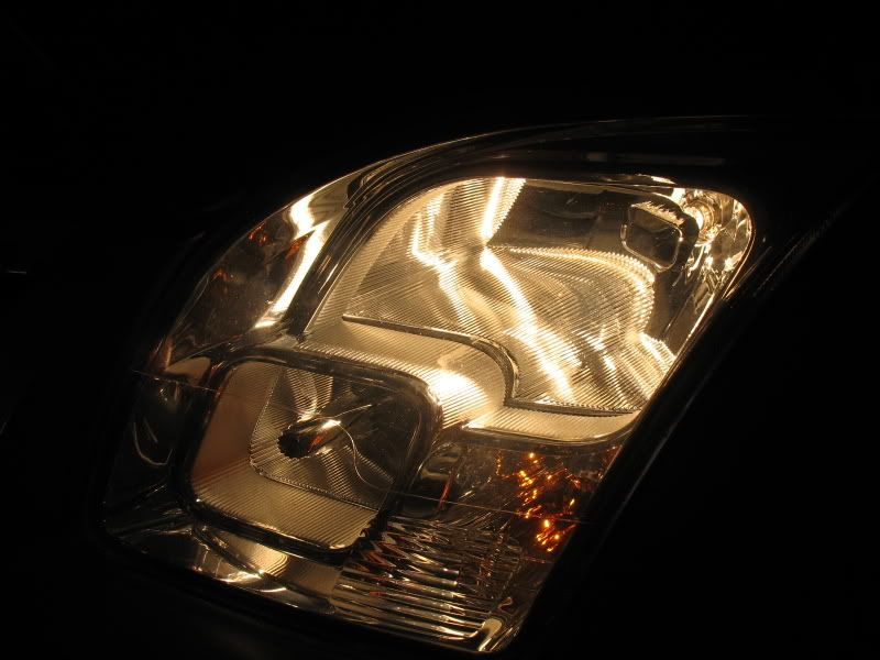

And now onto the results!
BEFORE
AFTER
BEFORE
AFTER

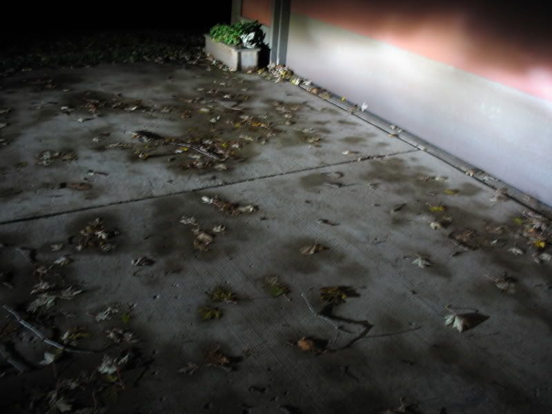

nice! do you have a pic of the light cutoff on a flat surface in front of the car?

Do you mean how close to the front of the car the light is laid down?

I wanted to see how sharp the light gets cut off at the top of the beam. If its a nice straight beam I think im gunna upgrade. But if it fades and isnt a nice sharp line i might wait on it.
Look at his last pic on the garage door.  There is no sharp cutoff.  The light is all over the place.

[quote author=Total ConFUSION link=topic=60924.msg1039302#msg1039302 date=1162163976]

If you want a sharp super straight cut off like with projector headlights you will never get that unless you have projector headlights. The fusion comes with reflectors headlight so the cut off is not as clean but still improves light output 3 X compared to your stock bulb. So bottom line you get a good enough cut off and a major upgrade in light output. :)
